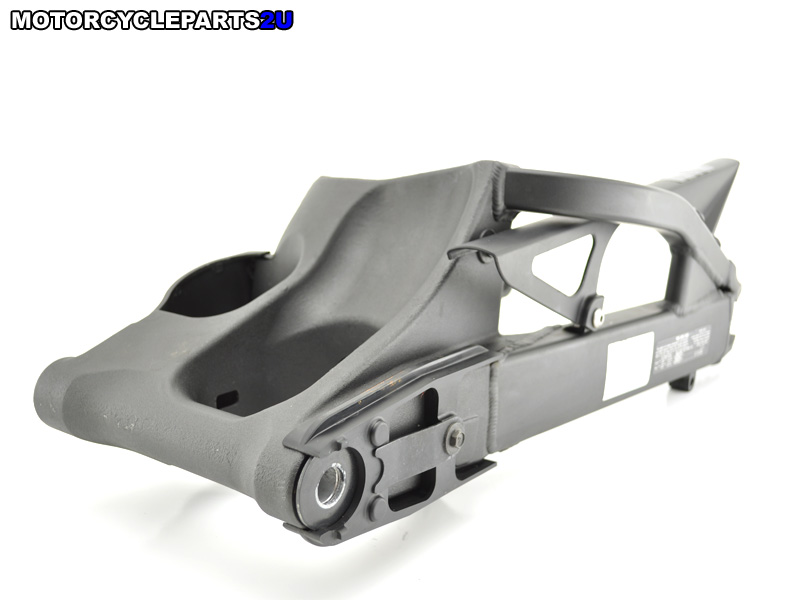

…is it meant to have two grooves in it where the edges of the chain are? Assuming it isn’t, what’s it called and where can I get a new one :w00t:
yeah mine is ridged up across the middle like that…
think it helps to track the chain or something…

called a chain guide and are really so the chain does not make contact with the swingarm.
I’ve never had one wear out and my bikes are high mileage - but definitely worth checking periodically!
Used to be called a “rubbing block” and they used to cut through quite fast but with modern materials (rather than soft neoprene rubber) they seem to last about as long as the bike. Providing you keep your chain adjusted.

Also sometimes called a ‘chain slider’ I think.
