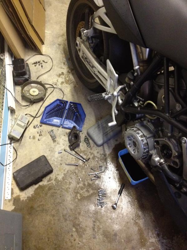

Now to the water pump seal on the Superduke. A known issue. Strip the right hand side of the engine casing. Clutch cover off, oil screen out (catch the oil- must remember that next time), drain coolant, write a list of where the different size bolts go.

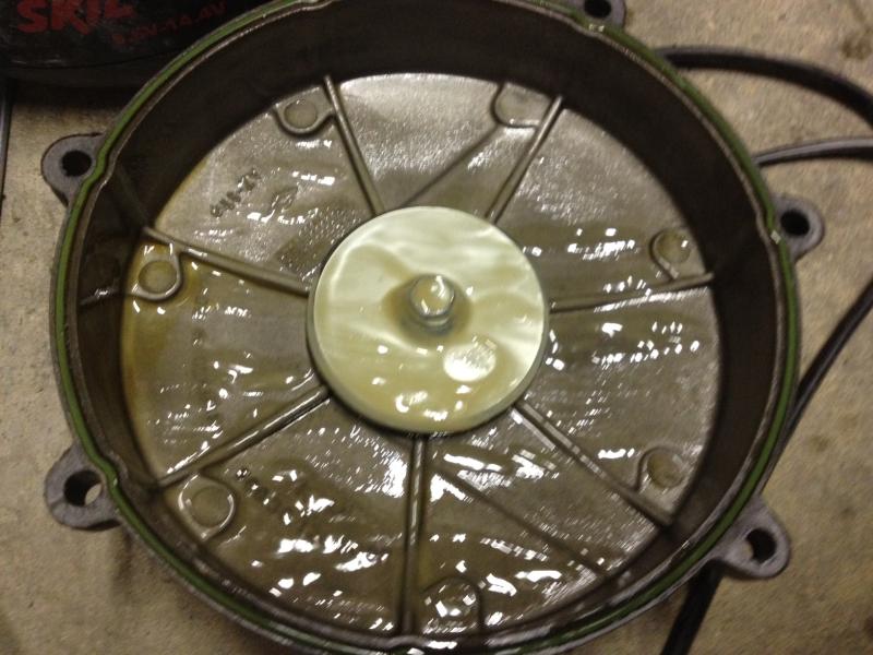

The telling sign that the coolant is getting into your engine, mayonnaise. This is the inside of the clutch cover.

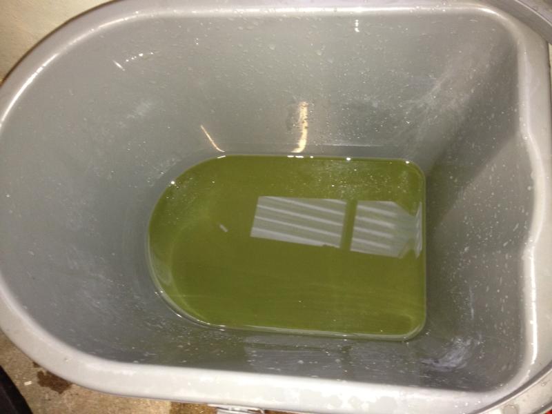

This is some of the coolant which was very dirty (its about 2 years and 6000 miles old) it had very fine particles in it, much finer than sand - clay sized, but it did settle out. This abrasive quality could have damaged the water pump seal.

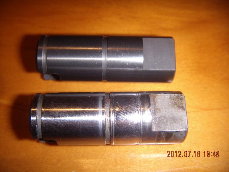

Here are the new (top) and replacement water pump shafts (bottom). You can see where the seal has worn the shaft in two places - there are two rings around it, allowing the leak from the higher pressure water side into the engine side.
I would have taken a picture of the water seals - old and new - but I butchered the old one getting it out. The new one was a bit of a biatch to get in, but using a socket from a socket set and a hammer on a block of wood got it in place. The useful stuff about how to do this is on the following link (thanks numnum). Obviously I took some short cuts, having spoken with Gear4 the KTM people on the phone and from whom I ordered the parts (about £27).
