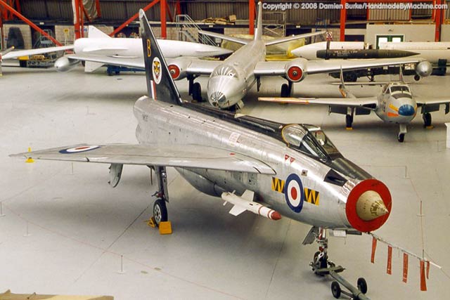

I first heard this many years ago at Duxford, when it was just storage for the Imperial War Museum, I thought it was just a tale to impress a 14 year old boy…
This is the actual aircraft, still at Duxford
