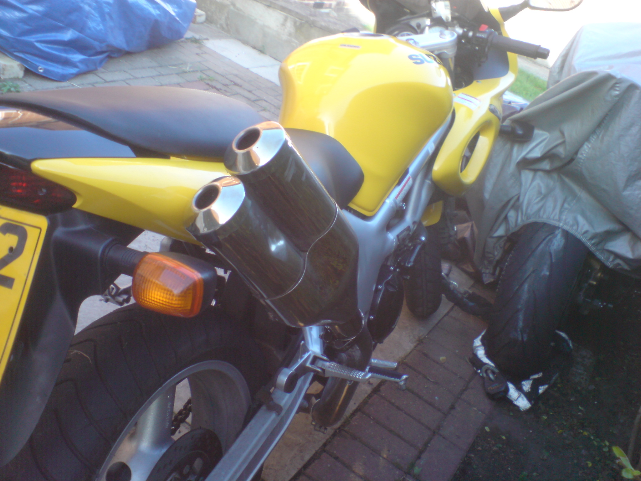

i try to download some pics
how about this for loud pipe;)
wait a minute how do you add a picture?

pipes?..ah…you want an M4, Scorpion( have these on my thou) or Blueflame ( had one on my 6).
you can my pipe on my 6 quite well hear;)
https://www.youtube.com/v/quCW7DIRkoU&hl=en&fs=1&
thats the pipe i have at the moment:D
I hope it sounds great in real life! It would need to be, to make up for that Scottish bagpipe exhaust you have there! :stuck_out_tongue:
Lovely dent and scratch. :smiley:
Doesnt it burn your leg ?
Might as well take the pillion pegs and seat off mate, would be a brave (or very cold) person to sit on the back of that! :wink:
