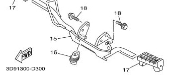

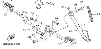

ok, just had a look at the stand and foot rest skeematics of the 2007 and 2009 ybr’s,
If im understanding it correct, it looks like u might not have space to put a side stand on a 2007 model.
Can u take a close in clear pic of ur left hand foot peg, getting the foot peg bar in it to were it connected to the bike. ( from just behind and below the peg, aiming forward slightly towards the front of the bike )
from the drawings i looked at ,the 2007 peg is attached underneath , comes out and up then bends out to the foot position.
the 2009 is attached above the bracket, then comes out a bit, bends down then out again to the foot position.
both brackets look like they have the stand bolt hole and lug for the spring, but the 2009 has a lot of clearence for stand as it is above and over it.
it looks like the 2007 foot rest bar is going to get in the way of the stand opening out fully to let the bike stand safely ???
( this is all from silly drawings so i am probably way off … )

Pics taken from Yamaha Parts
Select the model , year , then area of the bike ( in this case - Stand & Footrest ), for a parts list and picture.
YBR125 2007
YBR125 2009
Hey! Thanks for the reply. Looking at the schematics, seems like 07 and 05 are very similar. And I see what you mean about the footpeg being in the way but surely, if they sell it, it must work?! :stuck_out_tongue:
