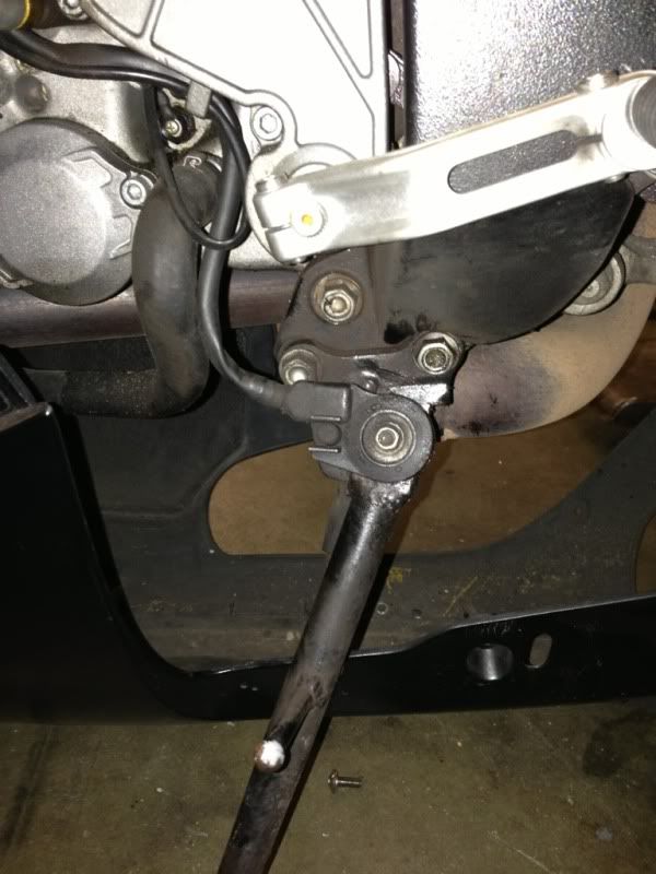

Old stand on
Take off the mid panels and take the 4 screws out holding the belly pan up then lower it to free up the side stand

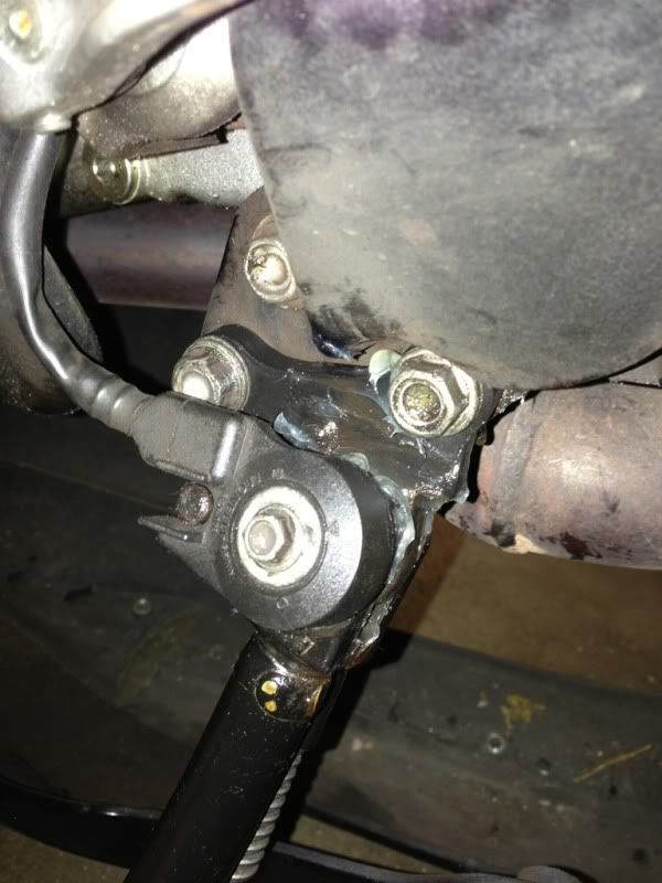

Undo the 8mm bolt holding the side stand switch on pull it to one side Leaving it plugged in. Undo the two bolts at the top of the bracket and remove.

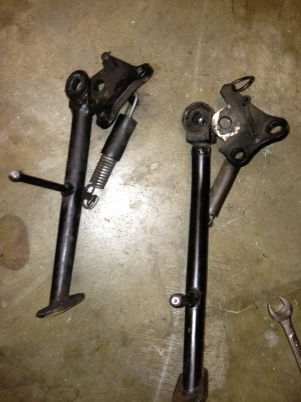

Take out the centre bolt holding the stand and bracket together then swap over the top bracket and springs from the rsv stand to the cbr stand. You can see how much longer the Cbr stand is compared to the rsv one.
I did notice the trick to getting the Stand together with the springs was to mount the springs with the centre bolt out then ease the bolt in half way. The should will catch on the stand in the middle so I just used a flat head screw driver to ease it up and the bolt went all the way through no trouble. (If its tight stop your more than likely cross threading it)

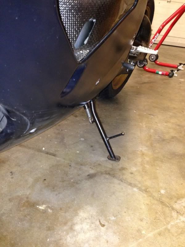

Back together mounted and slapped some LM grease on.
The bike now sits more up right but not by much. It’s now very sturdy when standing which I’m very happy with.
