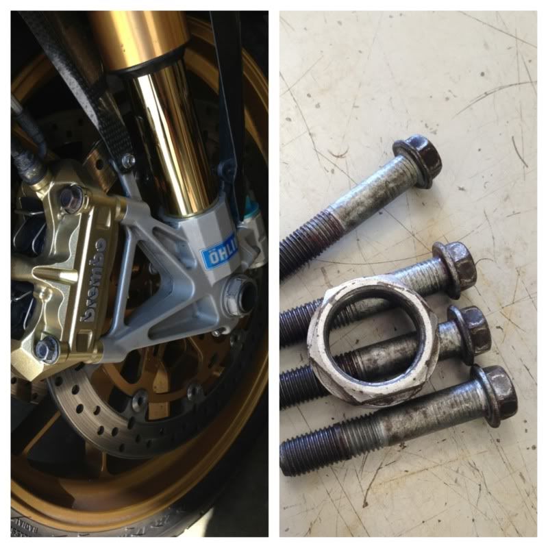

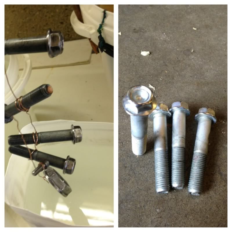

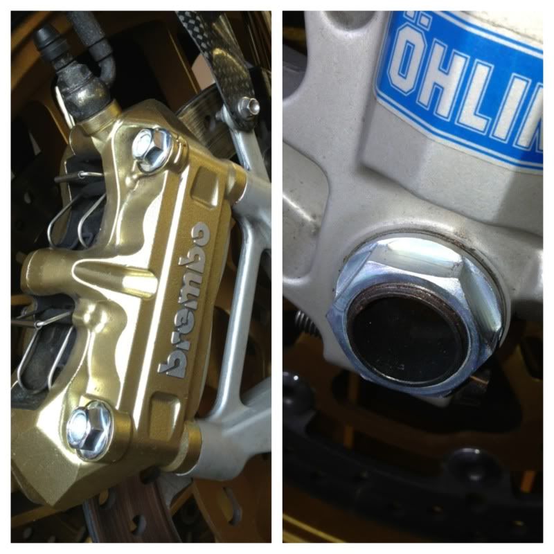

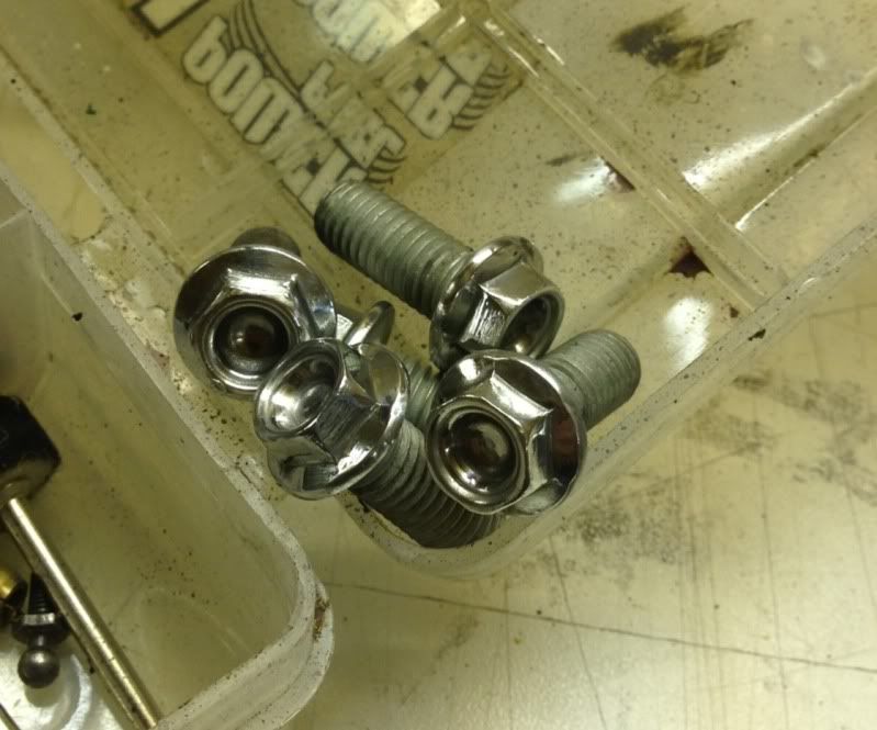

Here’s some of the zinc plating I’m doing.
Dont be shy, whats the method you’re using?
Electroplating
Have you made your own bath?
I sure have :slight_smile: got a set up to do silver/blue (in the pictures) and yellow/gold aka cad. Both are oem finishes to give the factory finish.
I’m impressed! You’ve made an extremely professional job of those.

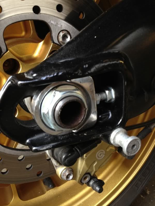

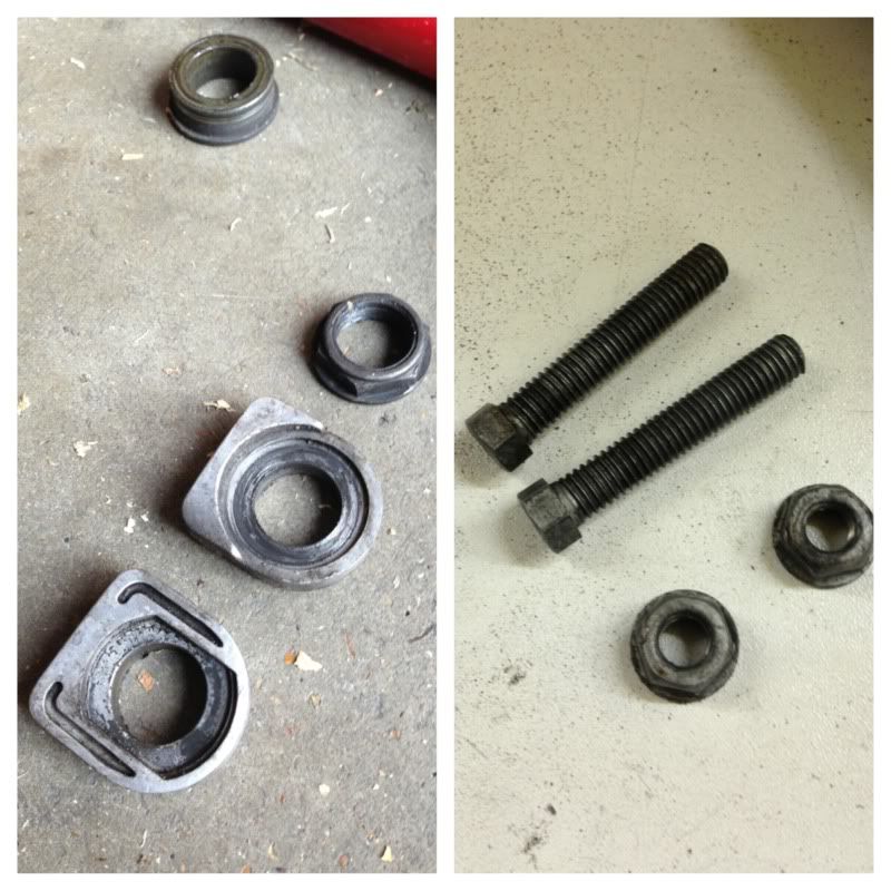

More done this time the rear axle nut and adjusters.
The blocks were ali so I just ground them down and polished them will finish them off once I’ve got some final metal polish the rest w as plated
Still lots more to do but getting there slowly
See in my mind, it’s a question of finding a suitable container, filling it with some sort of electrolyte, dangling some nice metal and the item in it, then running a current though them and the liquid
Is it significantly more complicated than that then? :smiley:
I really like the look of the items you’ve done so far, superb finish :slight_smile:
You are pretty much there expect for the ph control, the cleaning process ( acid and alkaline solutions), controlling the current to prevent “burning” the item and air agitation l. Those small items took over an hour start to finish then there’s the drying time preventing water marks, curing, and the finish buffing.
