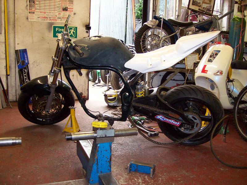

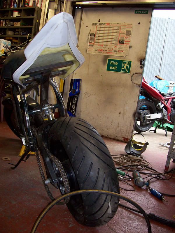

Made some progress this weekend. At least the rain is good for something. Still loads to do, waiting on the yokes so I can pin it all together.

I got a couple of pals have a workshop in Maidstone, after we measured it up they did the very tidy welding. http://www.motoliner.co.uk/ if anyone is intersted.

A small place in Maidstone a friend of a friend sort of thing. Its the first time he’s done anything that isn’t a straight replication. But it should be OK. He has all the sketches and measurements. I’ll post a pic once its done, so you can see how they turn out. I dont think hes that expensive either. He only quoted 400 for the lot, top/bottom and risers to accomodate some fatbars.

I dont have the sketches but they’re pretty thick (4 pinch bolts at the bottom).

It went in easy enough, had to shave 2mm of either side of the bandit and the shock mount was very similar to the bandits existing one, the centre stand had to be changes slightly to fit the linkage. I wanted to hide the subframe so we modded the mount to act as a brace for the top of the subframe.
I’m pretty happy with how it turned out.
