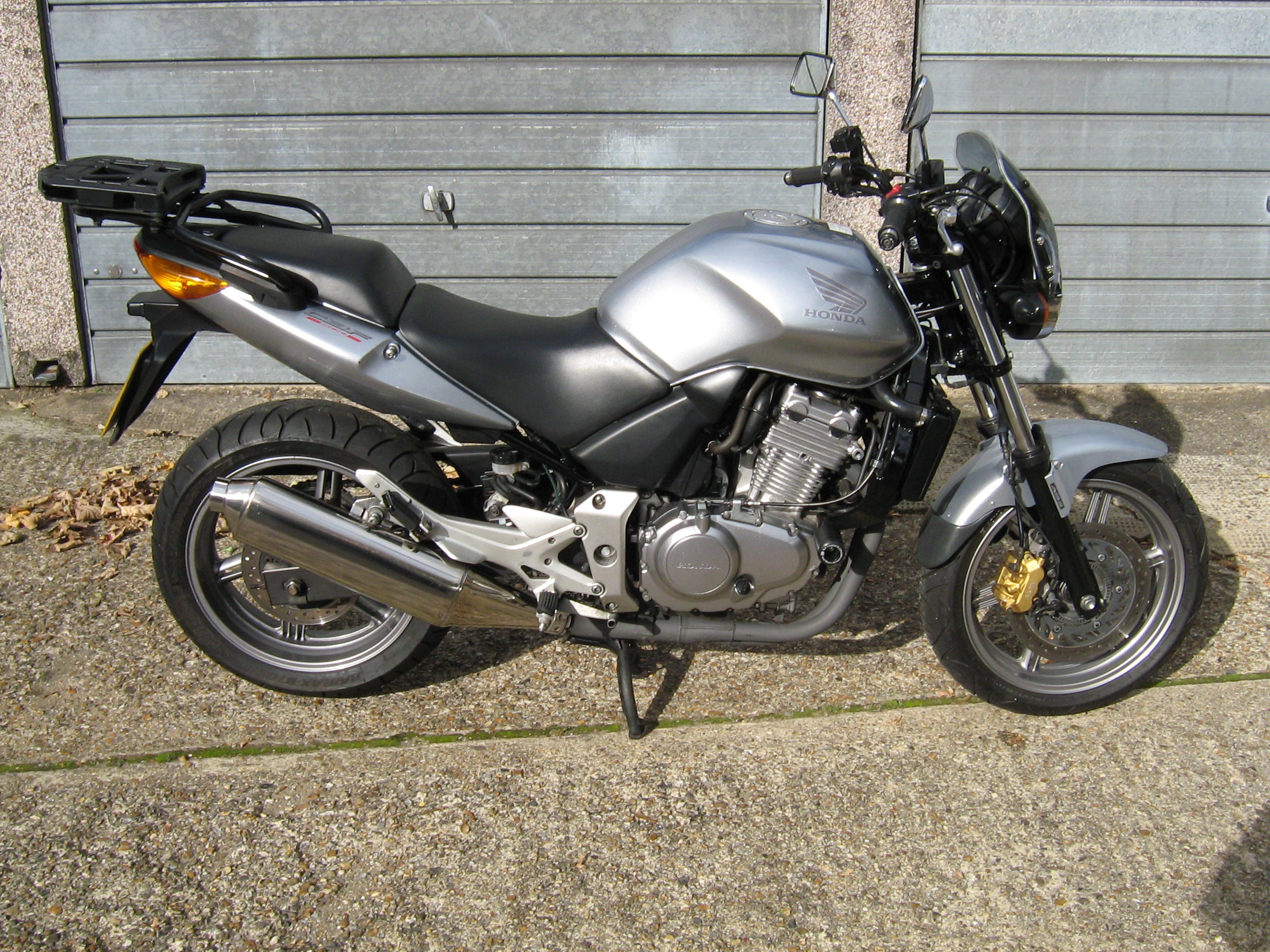

I did the downpipes on my 500. You really need to take them off, and remove all the rust. That is easy done with a an Oakey Sanding Star:
http://www.saint-gobain-abrasives.co.uk/pdf/Oakey_Cat.pdf
Page 19, you can get these at B&Q. It is handle all the surface area of the pipes leaving them bare metal. Wipe the surface with meths until there is no dark residue on the cloths.
Then immediately spray once dry with VHT (very high temperature 600°C) exhaust enamel available from Halfords. Follow the instructions and give it several coats. Your pipes will end up looking like the picture below.
I doubt that powder coating would have the temperature resistance and would probably burn off very quickly. And spraying whilst on the bike would not give you 100% coverage and the remaining rust would quickly spread under the paint.
