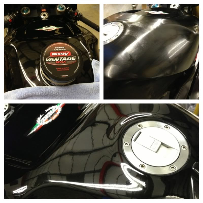

I wanted to do abit more than rub some tcut on my bike so I went and bought:
Soft start polisher/sander (looks like an angle grinder)
Backing plate and heads
Compound
Cubanna wax
Clay
Detailing fluid
Microfibres cloths
Drying towels
Shampoo
It costs a Bomb buying the proper stuff but should last awhile on the bike.

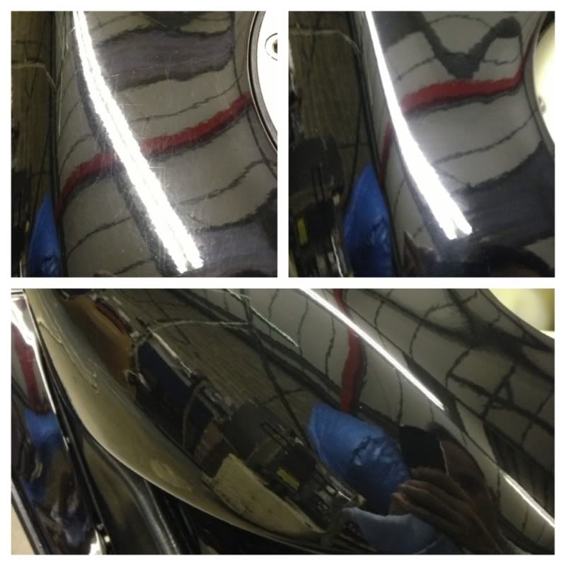

You need to clean the bike then dry it then clay it to remove an lumps or bumps like tar bugs stones hairs drift to prevent scratching the paint when using the machine polisher.
Clean it down then I mopped it and waxed it. So happy with the early results.
Not bad for two hours work

Conrad use it on something else first to check the rpm on the sander is ok before you use it on the bike.
The one if got is a soft start one so it doesn’t just kick in plus its a variable speed one for better results.
All you’ll need is a black polishing pad as its the finishing grade unless your gonna cut back more than light scratches.
Cool cool… I’ll be doing it on fresh paint so might start rough and work through the grades.
My sander is variable speed but not soft start so I’ll have to be careful!
Is the clay pretty much like using a tack cloth?
Yeap but more effective as you wet it with detailing spray and it glides lovely then just fold it over and keep going it leaves to flawless with a quick buff after then your ready to mop it

not a great idea to start mopping without doing paint depth measurements first incidentally. If its sub 80 microns then you can be saying hello to your base coat. The curves of the plastics and tank can also mean the edges of the pad can dig in and burn the paint.
