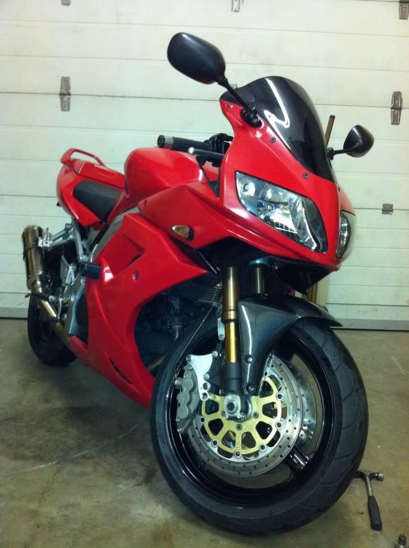

Oops I did it again
Done
Bravo, fair do’s. Selling, or keeping?
Well done m8!
Sell??? No way spent way too much to sell her now unless I put everything back to standard first
Thanks sneaky
Looks very good. Hope to see you out on it. (Mind you, we liked it when it was grey:) )
can’t say as I blame you.
The candy apple red will be back once I’ve got the money all that’s left is to tidy up the headlight loom and work out why the speedo is over reading.
It’s booked in for the mot on Monday so might be around for bm if I feel up to riding
good job man it looks great ! !
glad I wasn’t the only one!
Well done mate , glad your back on the road , let’s hope no issues with M.O.T
excellent work!! hopefully all being well we’ll see you on Wednesday.
All done she’s back on the road :slight_smile:

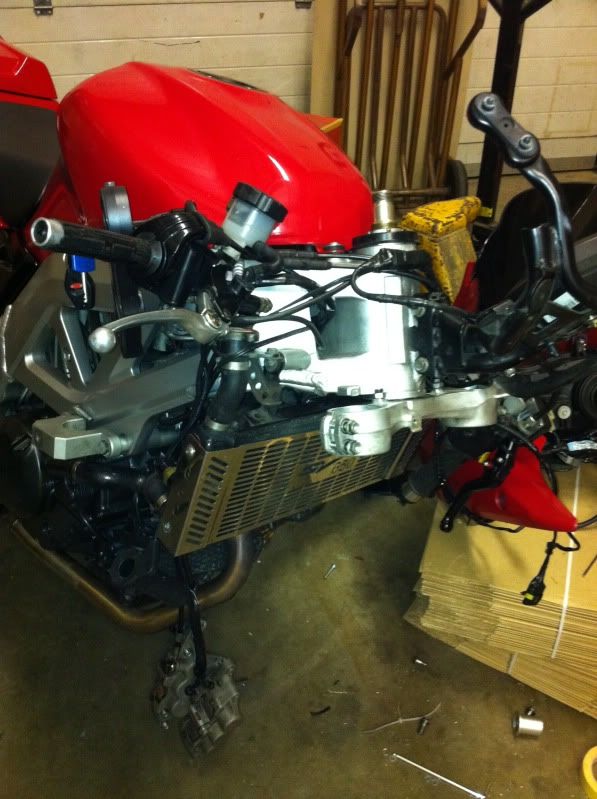

Just when all looked good I had to do this
what did you do and why? :blink:
did you pop a wheelie and then realised why you had a couple of bolts left over? :stuck_out_tongue:
If it was that major you had to take the front end off how did it get through an MOT?
What’s wrong with it Baz?
The lock stops had been ground right down so I made some temporary ones to pass which is legal but thought it would be a case of drill from the bottom and bolt the yoke but Nooo I didn’t have enough space to had to strip it all off just to drill two holes where the stops use to be.
Two nuts under each bolt head then nuts under the yoke and its sorted now my bars dont hit the tank lol. I’ll keep an eye out for another bottom yoke but this is fine even as a bodge it’ll be fine just not to my liking as I know it’s not right.
Oh yeah watch this space the paint job is coming back
Nufin wrong with allen cap heads for lock stops my boy, all the billet bottom yokes use capheads!See even my lush, made to order yokes have cap heads.
Ahh result that’s alright then, I’m still waiting for that missing lever to turn up in the post.
