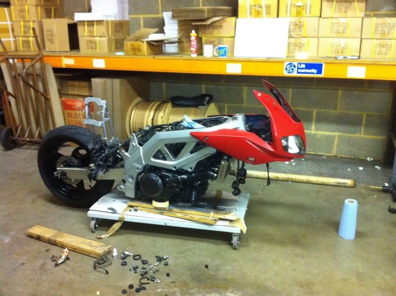

I’ve got 95% of the bike just afew more bits to sorce
Scary little collection of bits on the floor - hope you can remember where they all have to go back to:w00t:
Best of luck, keep putting up the pics:)
I hope you’re having that frame sprayed
i think he has done this so many times that he could rebuild the bike in total darkness while updating his status on facebook and hoping on one foot
ps glad you are putting it back
Glad your giving it another go mate , keep us posted , I love re-build threads.

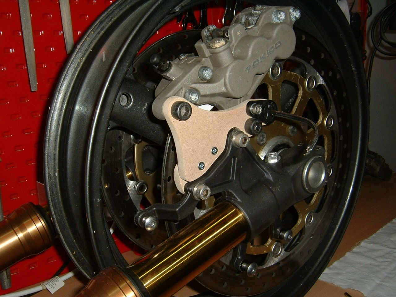

Cheers guys well here goes
I’ve gone for a gsxr 1000 k2 front forks
Srad wheel
Tl 6 pot calipers
Tl clip ons
Gsxr 1000/750 yoke combo

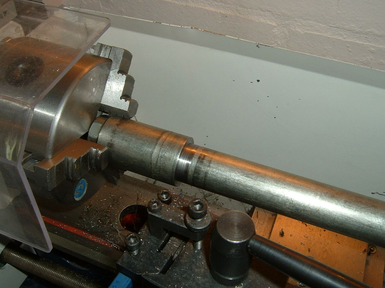

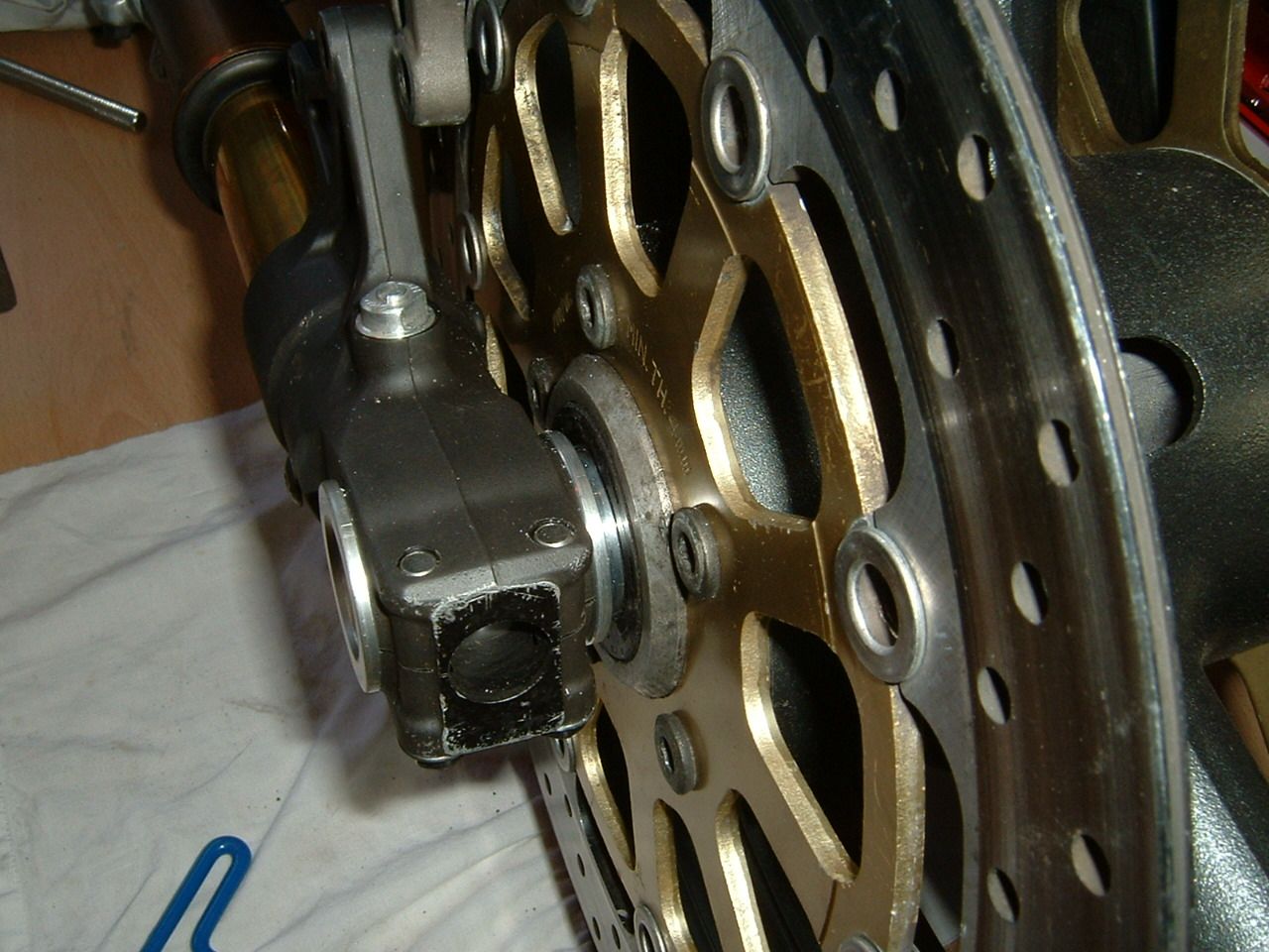

This front end is said to be “not possible” so I’m proving a point with this one all made possible by CABBIE who has helped getting this front end sorted.
He made a spacer for the wheel and designed the caliper brackets including the new speedo sensor
Once the caliper brackets are back from the Cnc guy I can build the front end in the mean time I’m stuck waiting

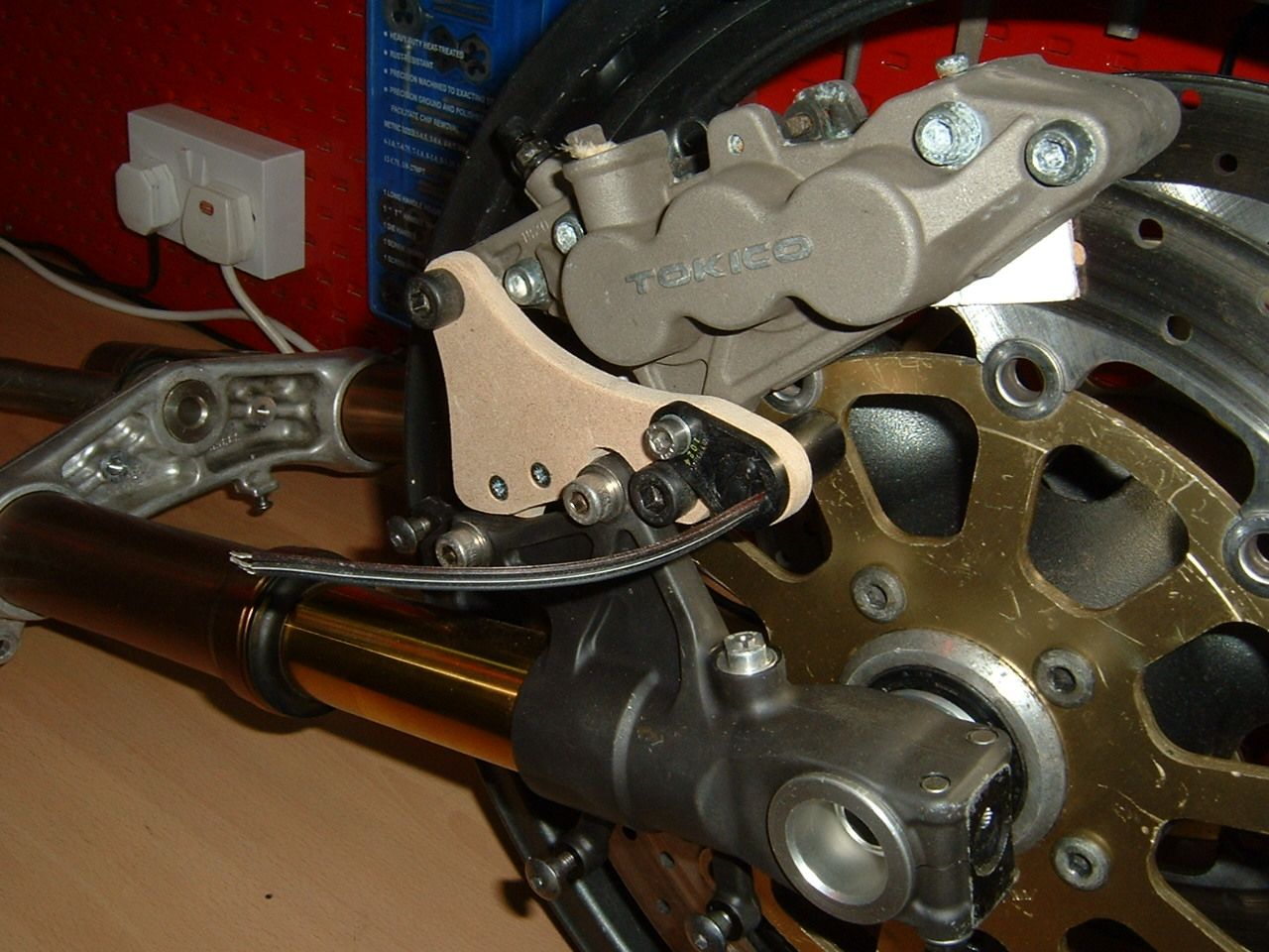

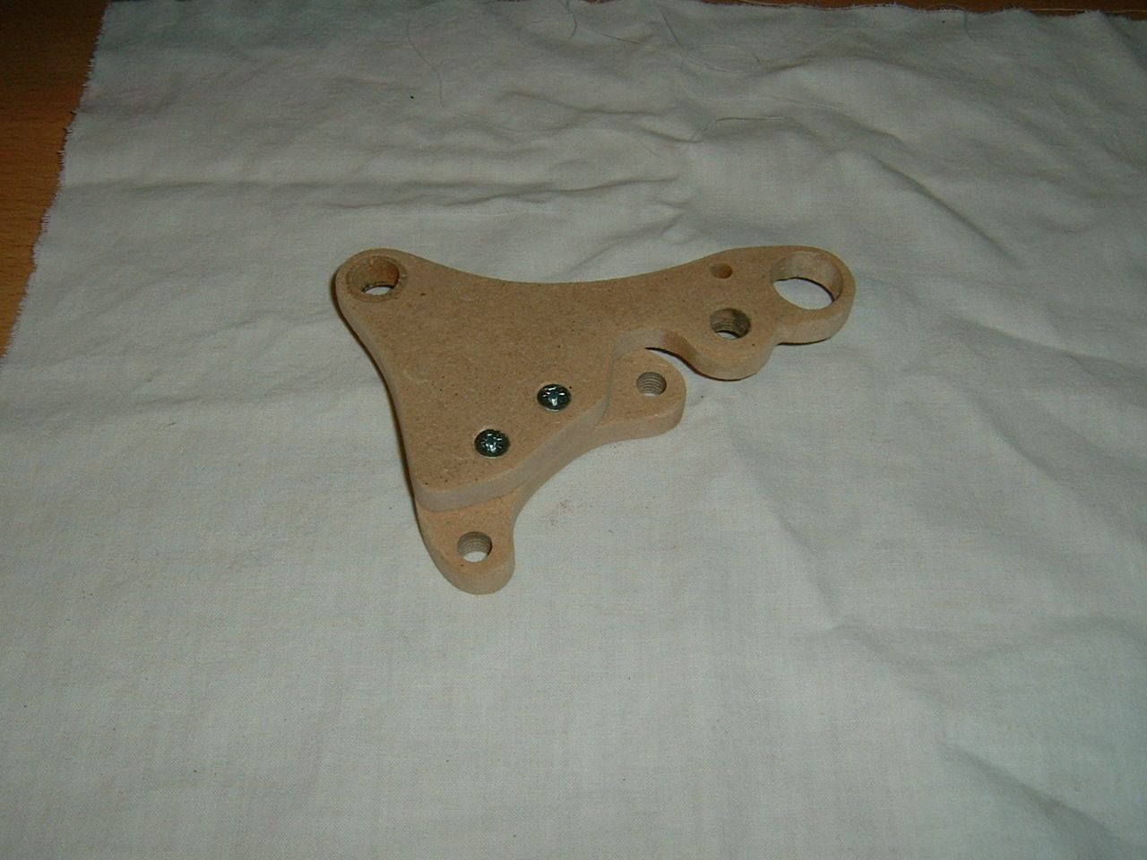

Just finished varnishing the caliper brackets, they look a nice oak colour now :w00t:
But I wanted oak
Why not fit the six pots on there normal mounting points and space out the disc to suit.
or are they not the K2 size calipers?
Good luck with it!
Their not k2 calipers so the mounting gap is 90mm on those ones

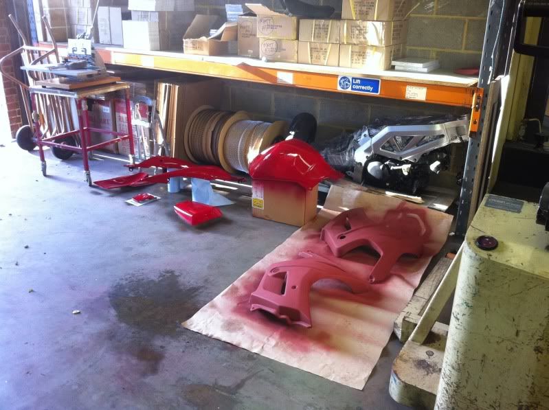

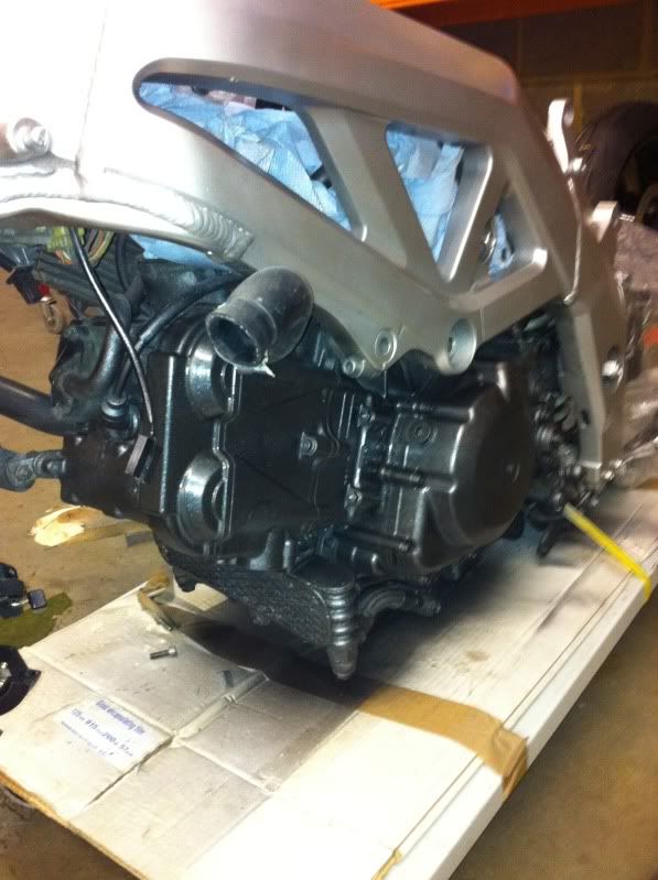

Afew pictures from last week of the panels, subframe, frame and engine painted
Looking good mate.
Mate I could have sold you a set of Kayaba forks off my K5, then you could have gone with 06-10 R6 calipers for the forks, using spacers. You’d prob have to bore out your top and bottom yoke, but then could fit a brace.
Don’t know fork diameter differences.
Tokicos (especially 6 pots) aren’t that great IME.
Speaking of my K5, want to help me strip that apart when you’re done
Nice one pal, looking at that MDF I reckon you’ve had some help from cabbie???
