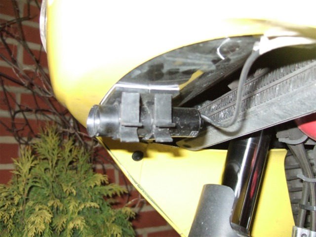

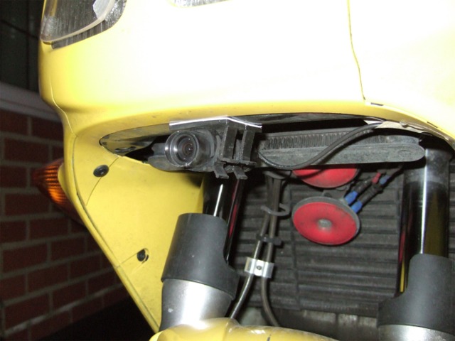

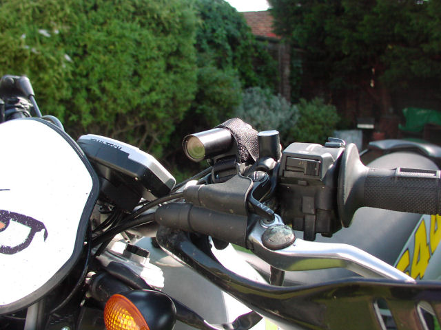

Here are a couple of pictures of the different mount setups I have used, current one under the headlamp on the VFR. I have also used the camera with suction mounts on the helmet and carried the recording gear in a bumbag, with great results…….tested the mounts at 130mph on track!
