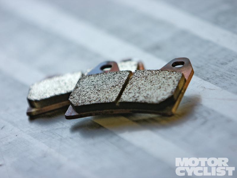

how do you notice when brake pads are worn?

When they’re below minimum spec, normally 2mm, or you feel they need changing. Some brake pads have a wear line in the middle, if you pop the pads out you can see if you’re past the line yet.

Checking brakes - some pads have a diagonal slot cut into them - when the slot runs out you need to replace the pads.
If not then just take a look at the pads - if the friction material (the bit that touches the discs) is getting too close to metal (the part of the pad the friction material is stuck onto) then change them. If you wear your brake pads down to the metal not only is this dangerous you will also have to replace your discs and they aren’t cheap.

with brake pads just shine a torch in at em and you should see how much wear you have left on them, good idea to know wot a new 1’s thickness looks like b4 though, lol

with regards to the breakpads, I must admit there is the problem that I have nothing to compare mine to. as in it’s my first bike so i dunno what normal is and isn’t.

This is a set of pads - a new set of pads have about 4mm to 5mm of friction material on them. When this wears down to about 1 or 2 mm you want to start thinking about changing them.
2mm to be on the safe side :slight_smile:
