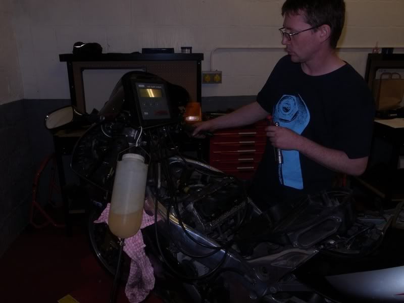

took it to the OMC and had a nice man show me how tune and balance the carbs:

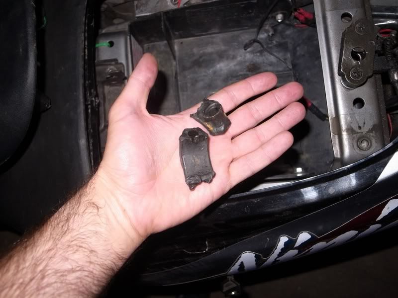

get towed back to my digs and my cousin found this nestled in my exhaust pipes:
that’ll be the cup round the bottom of a con-rod that has punched through the engine. meaning the whole engine is screwed.
