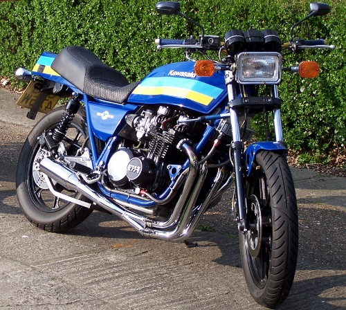

Moriwaki Bike Project.
Not sure it’s a ‘Classic’, but as my Moriwaki 750 is 30 years old next year i’m sure this is as good a place as any to mention my winter rebuild.I’ve owned the bike from new and has slowly evolved into its present form over the years. Usual '80’s mods…braced swinging arm and frame…Harris Works exhaust plus some mild engine tuning with cams and porting. Then various paint schemes until i finally arrived at the ‘Moriwaki’ inspired livery.
However it’s been off the road a couple of years due to damaged fork seals and tubes needing to be rechromed. Having other bikes has meant this work’s been on the back burner…until now. Apart from the fork service, most thats required to be done is cosmetic, some paint and dull ally. But this time i’m also carrying out some more modifications. So i’ll be replacing all nuts and bolts with stainless steel, removing all unused brackets from frame which i’ll then repaint. Engine out to be checked, then cleaned…same for carbs. Renthal bars to replace bling bling gold ones and mini-indicators in place of large chrome items.
I also plan to remove original clocks and, in their place, fit a LCD dash, with digital speed and rev counter.
Work has started on the paint on plastics and tank. I’ll then strip forks ready to go for re-chrome after the holidays. Then engine out, brakes checked, carbs sorted and anything else that needs doing. Hope to be back up and running in the spring and i’ll post up progress reports along the way…watch this space.:wink:

:wink: Have all the original parts, suspension, seat, mud guard etc, apart from the exhaust. Plus the parts i’m changing this time around.:slight_smile:
that looks tidy to me already.
Has now gone from this…
…To this;)
