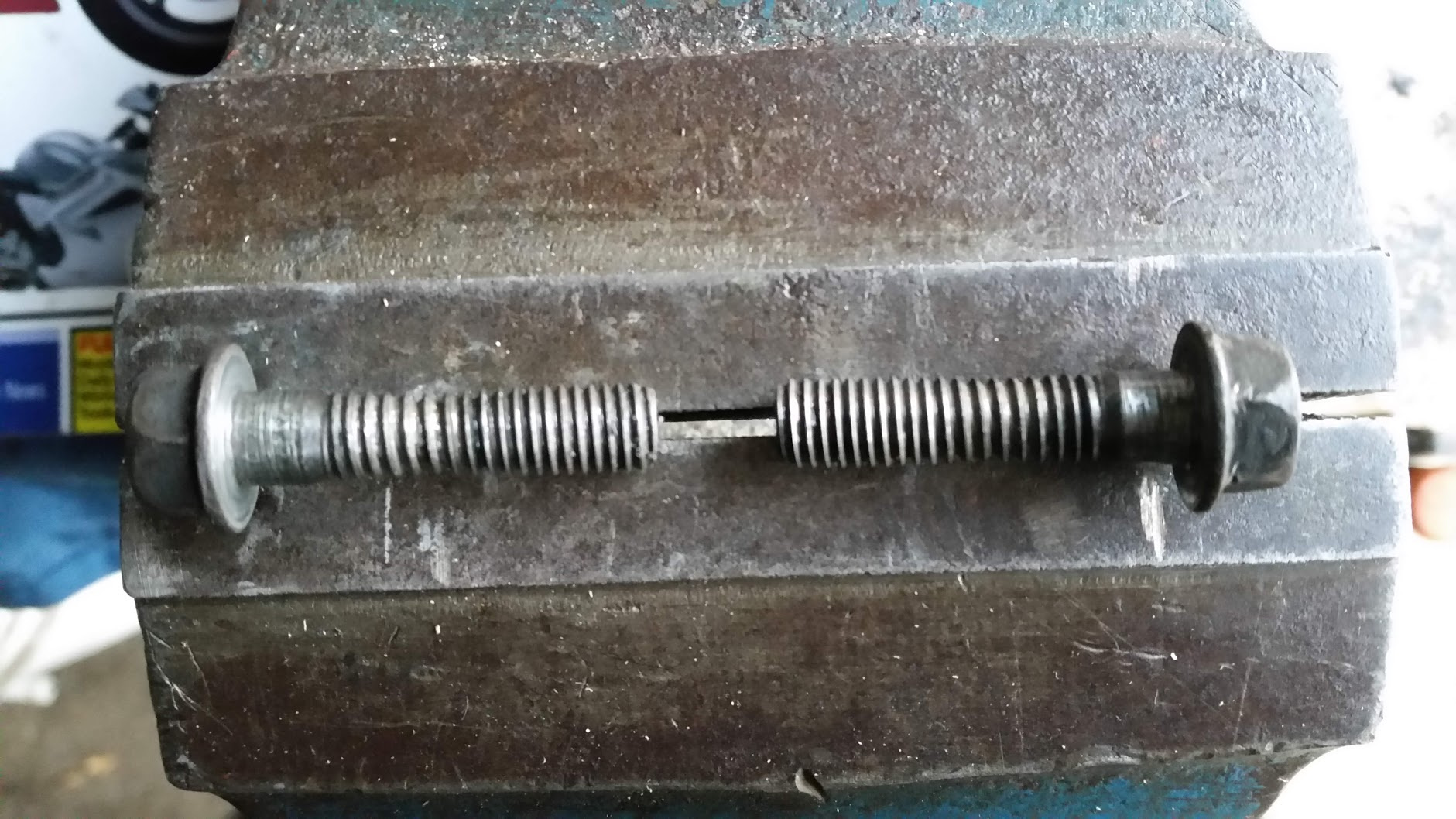

The bolts for one of the brake calipers might have been over-torqued at some point?
