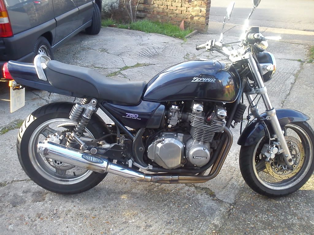

First you need something to spanner … Now what your looking for is something simples . You don’t want complications from parts not essential . So I was found one of these …
Not a bad bike as it is but it runs like a three legged camel ripped to the humps on whiskey . It has a dodgy steering lock fault and leaks oil .This will not do . It looks okay … ish as it is… however if there was another one and you parked it next to that one it would look the same …Thats because a factory built it . We can fix this problems .

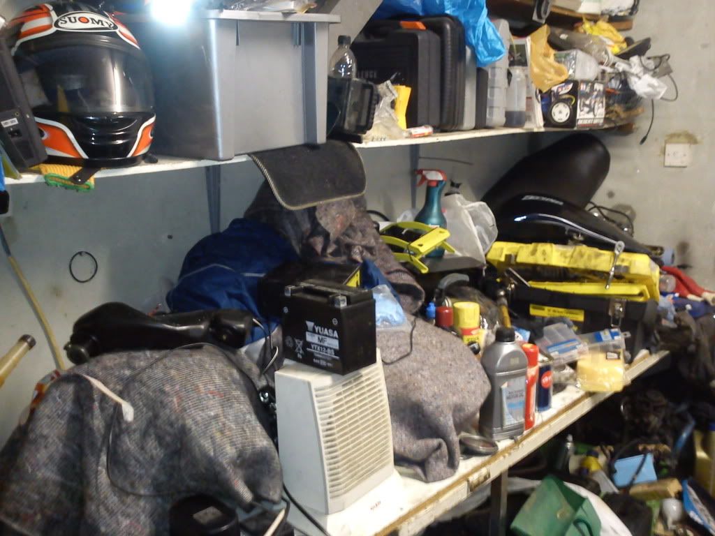

Next having got the bike you need to tidy your workspace … before .
After …
Thats that taken care of time to move one …

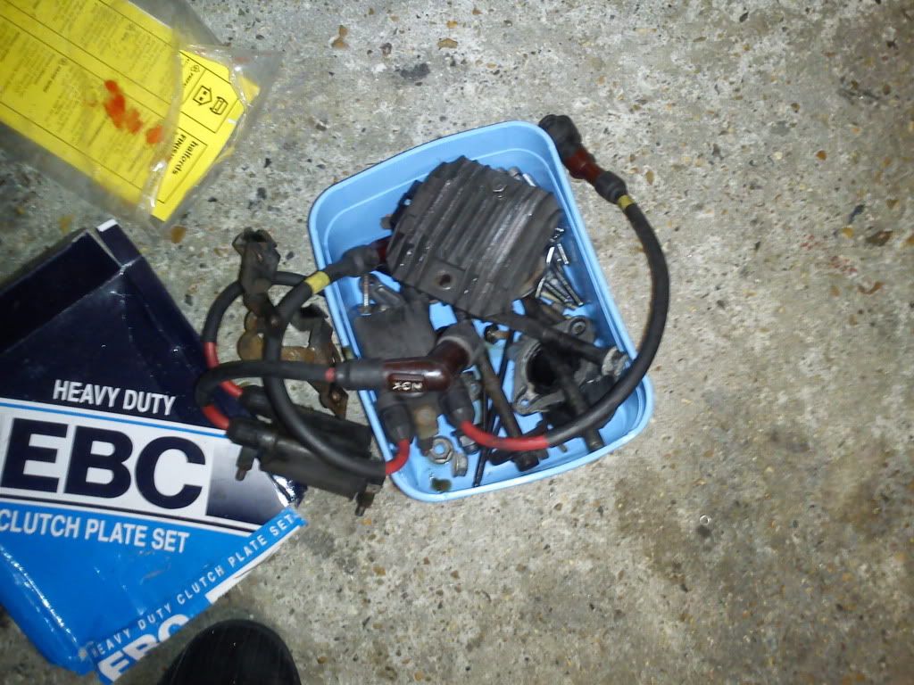

Next thing you want to do is get a tub . You will need a tub for all the bits that you might want to keep . This is a good tub as it already had some parts from a bike in it . Sooo then when your putting it back together bits left over seems more natural and less stressful .

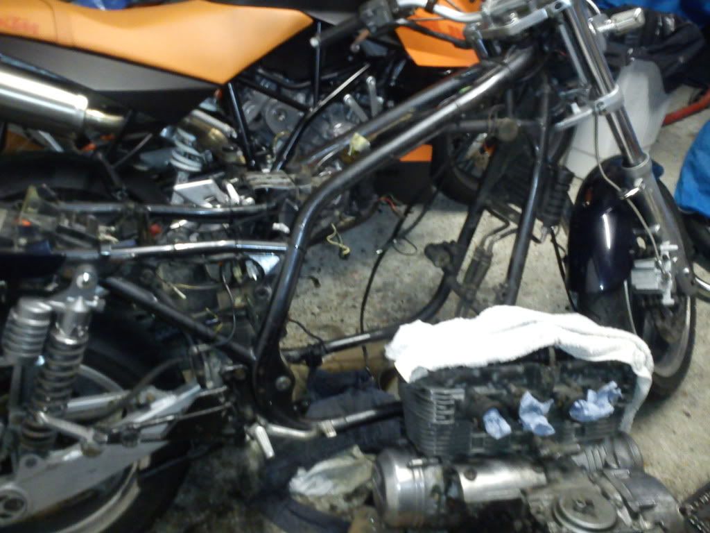

Next come disassembly . Just keep taking things off till you run out of bits . Keep throwing it in the tub making sure to get it well mixed up . Wiring loom now as you can see I have labled nothing . This is important never label anything as you wont learn doing it that way . Also they label thing on that choppers programme . If they do it on that choppers programme its probably wrong . So eventually you will end up with some thing that looks a little like this …

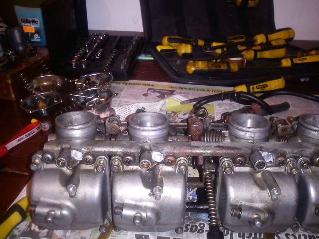

So now we address faults as we know them … It runs like the above camel so I attacked the carbs and found 3 out of 4 slow jets blocked completley . This is a good thing as its kind what I suspected .Various other bit of nasty floating around . Carb diaphrams etc were all in good nick ,so I cleaned them out with my dentist tool kit and thinners .Do not get thinners on diaphrams I dont think they would like it . Then I put them back together and gave the outside a good clean . Quick piccy showing outside clean and the tops ,needles and springs all cleaned shiny and smooth .
Next is oil leak . On an old engine the first thing is to see whats going to snap and whats not . So I have snapped 1 cover bolt and one engine mounting and someone beat me to an exhaust stud …so far . Nothing serious and we shall come to them later in the recipie . All the rocker cover bolts came out which was nice . Source of oil leak … There was about 75% of a gasket on the rocker cover .

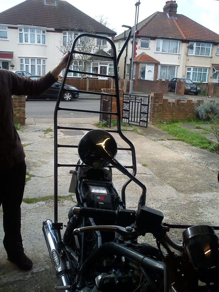

I should add … as this is a Kredit Krunch Kwak we shall mostly be utilising what is already lying around in the garage . We are doing this on the super cheap . Really going all out on budget bodge jobs :smiley: . Colours will be decided on by whats in stock . I have limited my spend budget to £200 … yes a paltry amount compared to some … This is following the choppers programme rule … If they do it ,its wrong . Styling is important you should think about that from the get go, as it makes it easier if you have a picture of what you want in your mind … well I think so anyways .Here I am experimenting with cissy bar ideas …

(BTW using that as a cissy bar will make the pillion have lines on their back)
