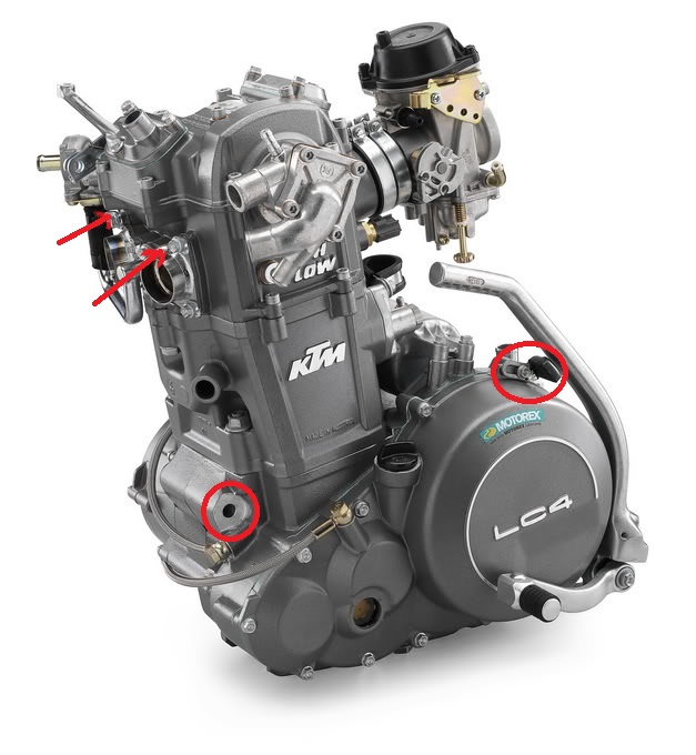

Drop the oil and check 19mm screen and 13mm magnet bolt to see if there clean. if the oil is still good then pop it back in.

Check this points.
Kick starter rubber stopper is holding the lever, mine made a rattling noise cos of that being lose.
x2 exhaust spring eye washers, i had a spring rip thru one of them making header pipe loose.
Also check brackets holding engine, not very likely to be loose but worth a check:)
Also have you recently fitted a sump guard alloy or plastic? they make things so different esp the alloy ones
