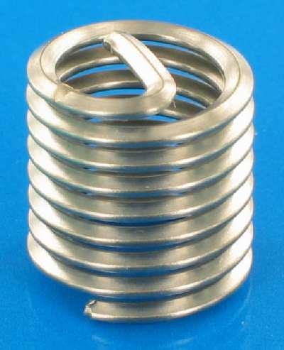

Hello fellow biking folk.Quick question about helicoil inserts - the small bolt that secures one of the rear hugger fastening struts to the swingarm has popped out - close inspection shows the thread in the hole in the swingarm which the bolt screws into has stripped.
I’m guessing I need to repair the thread with a helicoil insert so I can thread in the bolt and secure the strut - is this something i should take to a garage or is it worth buying a helicoil kit and simple enough to DIY?

It’s worth buying the kit, but I would go for Time-serts - they are stronger and more durable than helicoils.
Used to use them all the time when I were an engineery type :slight_smile:
Personally - I would just whip the forks out and take them to someone with a flatbed drill who does this kind of thing for a living. . . :smiley:
Thanks G - i’ll check out the Time-serts - p.s. will this involve more drilling. . . :ermm:
aye, more drilling…:wink:
time sert is a far more superior and permanant repair, helicoils tend to come out with the bolt again whereas time serts stay put and are often stronger than the original thread !
time sert is stronger and more permanent than heli coil , been using time serts for years and never had one come out when removing a bolt
