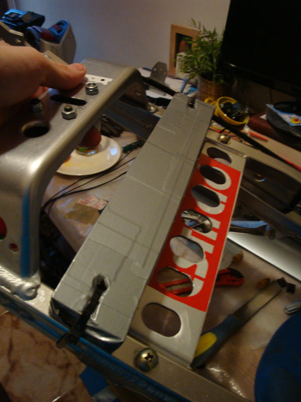

Today I managed to drill some holes in the pieces I have been cutting and fitted them to the sub-frame.
I’m now in the middle of making a less ‘busy’ version of the tail tidy.

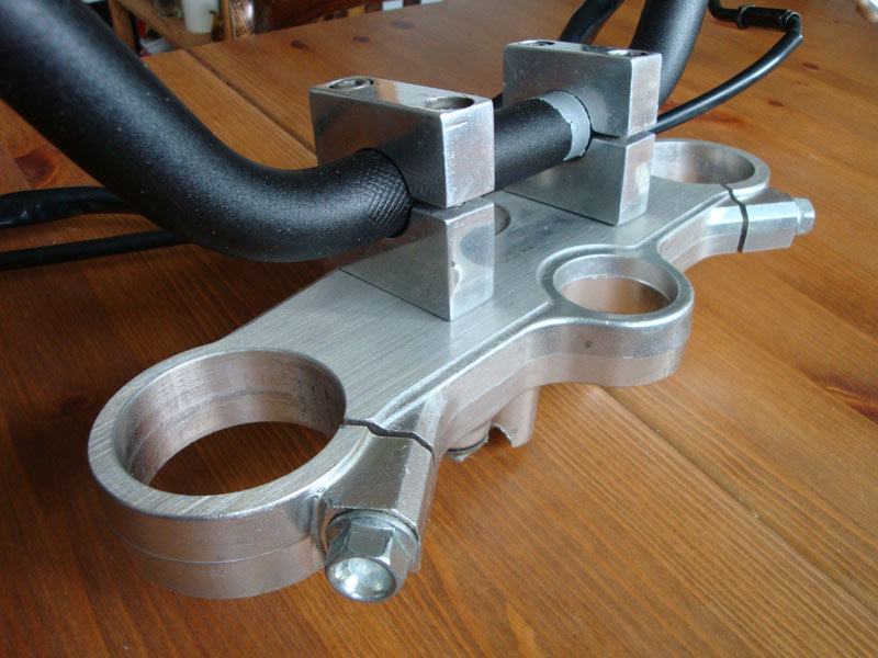

A bit more progress as I managed to swap my Oxford Sports bumbag for some Buell XB bars.

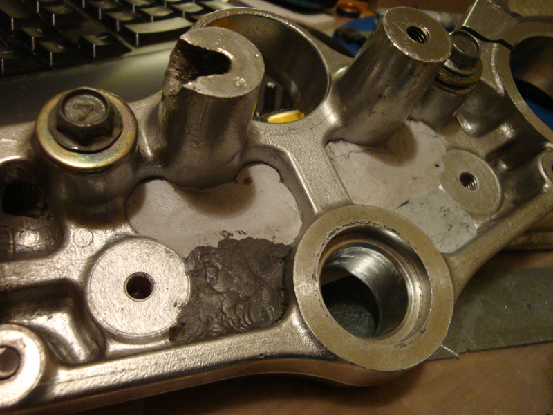

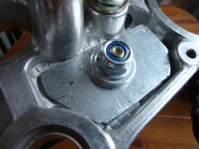

Filled the webbing in my top triple.
Measured, more than twice, then drilled it out and fitted risers and bars.
Made notches in the bars, well, on one side, these are really tough buggers and burnt out a couple of drill bits trying to do the other side :confused:
The result being that only one switchgear is on ATM.
Also made a support for the rear fairing.

not sure but be careful on the single bolted risers, most people use 2 bolt risers when fitting to a yoke which normally had no risers.
when you get bars for it see if you can get risers welded.
Really?
On CF, OSS and other sites I’ve never heard that. Of course two bolts would make a more secure fit, but it’s not a mega load bearing joint like frame -> shock or swinger -> frame.

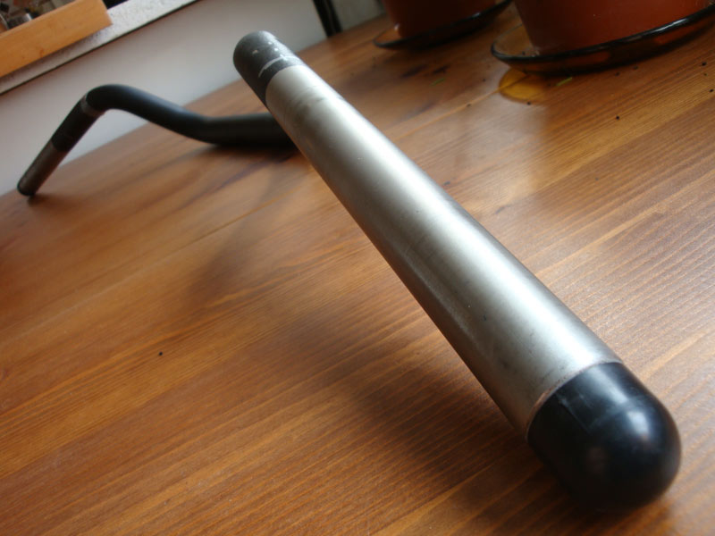

Hopefully my drag bars (see earlier in the thread) are coming to Barcelona at the end of the month. I just need to get them anodised or change the colour somehow - any ideas?
yeah just saying the 2 bolts would be better.
True.
