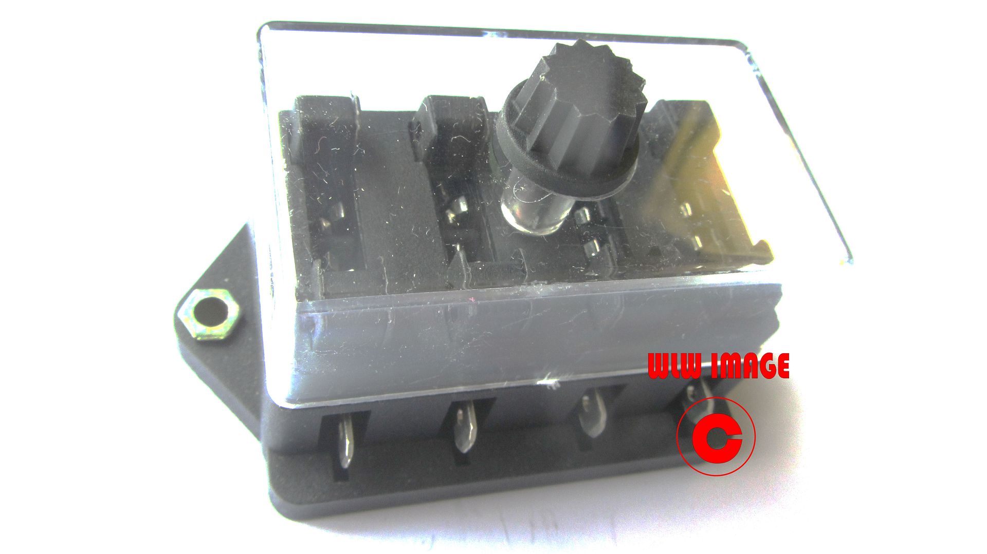

I’m planning to wire one of these into the Honda battery when I get a round tuit.
ebay link here
Its a four way fuse box. Wire the fuse box to your battery via 20 amp rated cable and a 20 amp fuse, then you can easily add up to four bits of kit and protect each circuit with the appropriate fuse. I’d doubt if you’d need more than 4 additional circuits but if you do then plan ahead and install the six way fuse box.

Art, the fuse box look pretty handy. might even use one of those myself.

I bought one of those boxes before. with the knob on the top, there’s no where to mount them under the seat.
you’re better off getting 4 of these http://www.ebay.co.uk/itm/WATERPROOF-20A-Inline-Standard-ATO-Blade-Fuse-Holder-Fuse-Blown-Warning-LED-/301307817728?pt=UK_CarsParts_Vehicles_CarParts_SM&hash=item4627586f00
