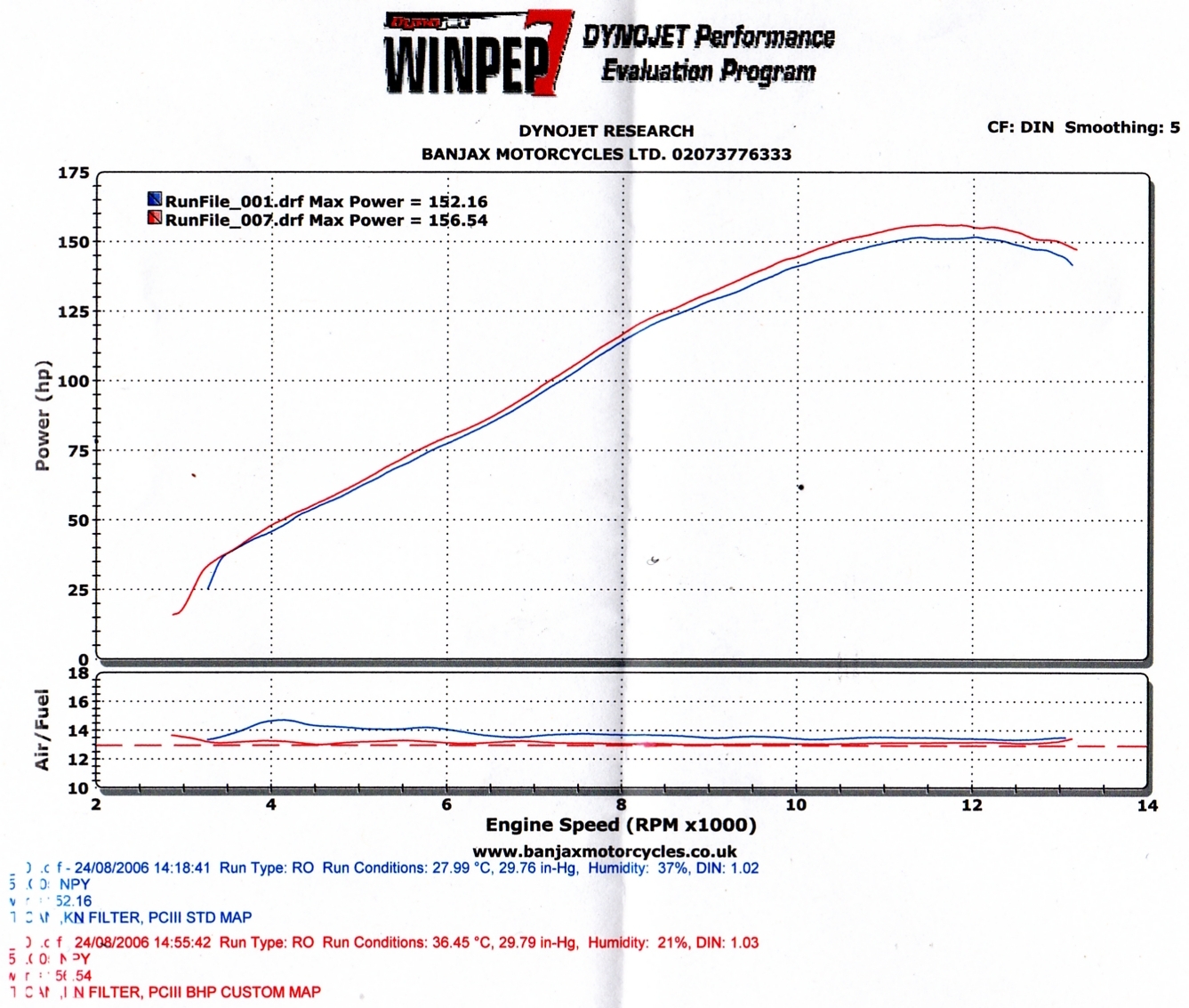

I’ve attached the graph, what do you think?

It would help to see it if I attach it…
Interestingly there’s no torque curve on that graph. Did you get another sheet with it on mate?
Performance gains aren’t huge to be honest, but it’s a smooth curve, which is the aim of the game, not outright power increase.

Two very good a/f lines there! Which is why your bike is running so sweetly.
I suspect that Banjax numbers are lower than other dyno’s because I was chatting to someone else recently who had their bike setup there, and I was also suprised how low their numbers are. Not sure if it is because of their tuning skill, their dyno, or the corrections that they do/don’t do???

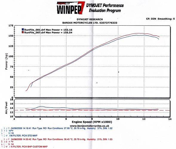

Hey Jay, I’ve added the new graph with Torque curve.
Any comments?
