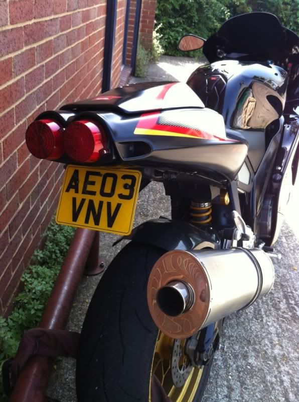

General check over and new flasher relay as the other one was dead thanks to a mismatch of indicators by the previous owner.
Full set of Oxford eyeshot nano indicators but this ment I needed to run some 1a diodes to stop it back feeding through the dash and making the other side flash aswell which also knocked out my fuel light and I ran out :frowning: the other wires are a ground return

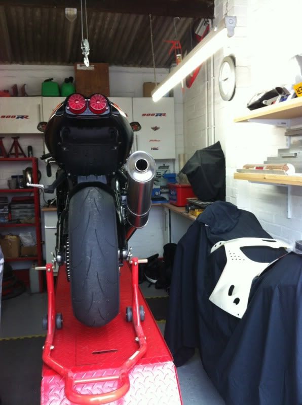

Off I cabbies to cut up the undertray as the tail tidy was too big. He made me up a tidy bracket and cleaned up the plastics for a clean simple look
And today the ecu race chip turned up from af1 racing in Italy so now it matches the race can and filter :slight_smile:

Barry, Is that rear tyre shot? The angles on it look quite severe?
Glad your getting the niggles sorted. Looks a lovely bike mate.
Shorten the standard can???
Suspension set up and your done!
Rear tyre is on the markers on the right side.
I want to cut the can but it’ll just muck up the fueling so I’ll leave it full size

lucky the bike didnt fall off the bloody work bench with the wheels hanging over the edge!
If he was at cabbie’s workshop then he’s in very safe and capable hands
i have seen GP mechanics drop bikes off of benches :wink:
