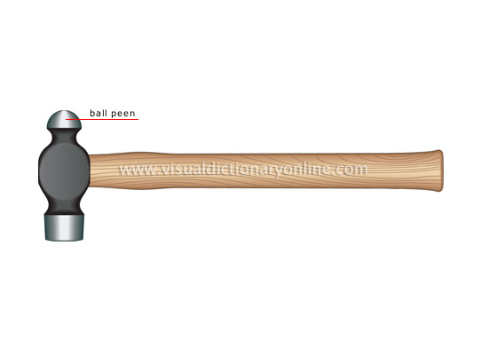

Same as me man, for bloody years i use a lump hammer one side and a ball hammer to do the rivet !

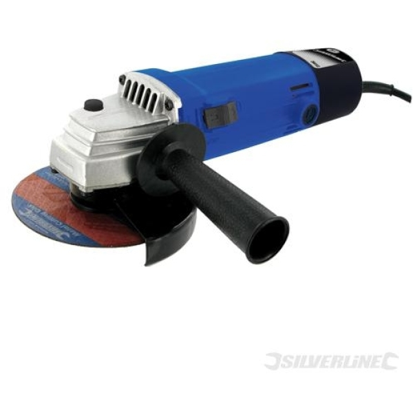

Assuming you don’t want the chain for re use, the 115mm ankle grinder and a piece of scrap wood is the best chain splitter. An old flat iron, a centre punch and a 16 oz ball piene hammer does the new rivet.
That said, the right tool does make life a whole lot easier.
