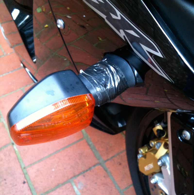

I went to see a cbr 600 rr today and noticed a couple of things ( I’ve attached a few pics to help explain):

  3. The indicators on the right hand side are taped up because they seem to be popping out of their housing, any ideas on what’s causing this? (the LHS pic shows it starting to pop out too)

get some aftermarket indicators :smiley:

Indicators are just the usual shoddy Honda workmanship…
