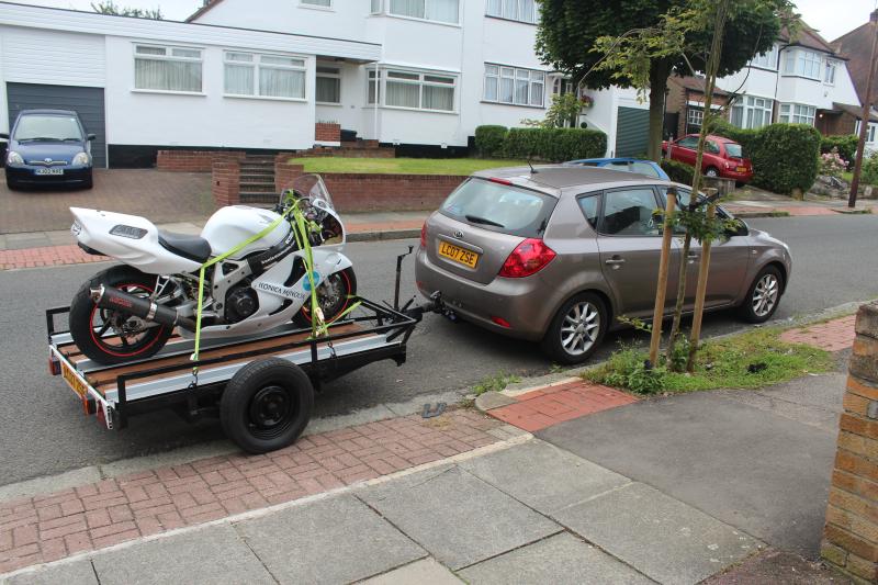

Mine will (in theory) take 3 bikes. General opinion of those that have seen it is I got it at a steal for just £150 as it’s very sturdy, suspension and everything.
My logic was a 3 bike trailer means use the middle runner for 1 bike, the two outer ones for two bikes. I’m not sure how comfortable I would be with two on there though, just because you really want something outside the bikes centre of gravity to stop it falling inwards and that’s not possible when they’re right on the edge. Any ideas people?

I’ve not really looked tbh. With the bike on the trailer and me bouncing up and down on it to get the straps tight I had no concerns at all though. I would only be careful on the wooden boards, they bend a fair bit when I stand on them.
Good picture … of an illegal trailer. Excuse me, but where are the mudguards?

Yeah, someone else mentioned it should have mudguards. I’m guessing it’s not high on Police lists though as I was in traffic next to a Police car for around 15 minutes, on the M25.
Are there any specs required, or can I stick some Kelloggs boxes round the wheels and claim they’re mud guards?
Don’t quote me but I seem to remember that the "Vehicle(Construction and Use) Regs used to required the wheel to be covered from level with the hub at the back to some where (?) beyond the top.
Hardly a motorcycle on the road that complies with that now so looks like almost anything will do. Oh. Once fitted you are supposed to have outboard red reflectors on them.
Seen any of them on a shop bought trailer recently?
Looking at your trailer, I’d just cut some aluminium sheet, bend the front and rear ends down a bit and pop rivet them to the side rails. Put a couple of bicycle reflectors on them and the old bill will be well impressed.

Trailer must also have a safety chain from the tow hitch to the trailer " that one can earn you a prohibition notice"
Was quit amused by AndyCr15’s trailer as it appears to have leaf springs.
Cheers Steve
Yeah, it has a safety, erm, bit of wire…
