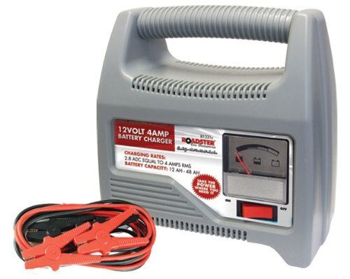

Hi guys,
From the subject I am sure you can tell I am not a very handy guy, in fact I am a man who pay man to do a man job, so these questions might seems silly to you but please help.
Winter is coming if it is not here already and i don’t use my R1 a lot in the winter but every now and then I like to take to out for a ride in case it feels lonely in the garage on its own, so i need to get a battery bosster/just start charger in case the battery goes flat but I am not sure which one. I know it is a 12v battery but some charger says 12V 4amp and the other says 12V 8amp, so which I should I get? doesn’t really matter it is a 4amp or 8amp?
Cheers guys

Thanks for the replies guys. ok, i think i need to give you a little bit more details to help you to help me.
The bike will be parked in a garage with no power source, so the idea is I need a device (whatever it call which I am no so sure) that I can charge it at home then take and connect it to the bike battery to help it to start or jump start as you might call it when the battery is flat. Am I making any sense to you guys?
This is was I was looking.
I hope you guy understand what I mean as I said I am no good good a man job LOL
