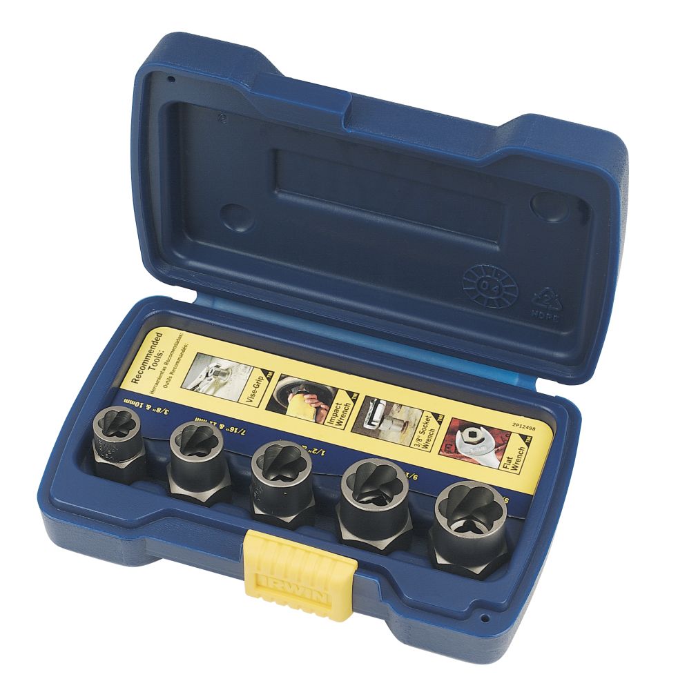

As an aside, but closely related…‘Argggggggghhh, removing a rounded bolt’
I found these to be worth their weight in gold…
Irwin 5 Piece Bolt Grip Nut Remover Set
Remember to use lithium grease when replacing all nuts and bolts and if you can afford, buy stainless steel replacements to reduce the corrosive effects attributed to the cheese like alloy the Japanese factories use as standard.
