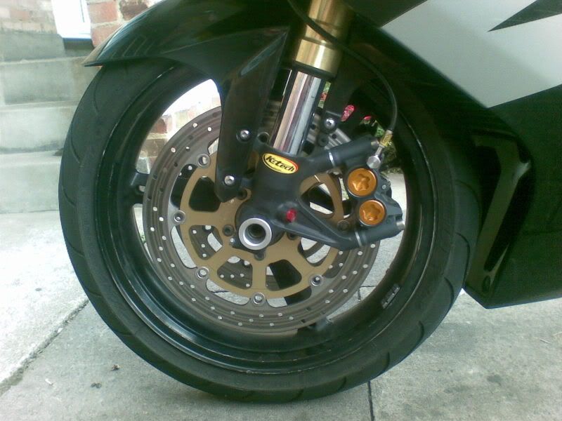

like so...
thats on the front of my k4 750, the wheel is the same as yours, the disc is 320mm from a K3 750,(k1/3 600/750,K1/2 100 and srad discs are the same)
the calipers are of an 05 R1 and theres a 5 mill spacer

thanks ive been looking at what calipers and disks fit mine and the calipers look sweet:cool: now i know the srad disks fit i know a company that can supply me a sweet set of wavey ones for around the £130 mark, but at the moment the funds are low and the brakes are awesome with the new M/S fitted, i have a set of bendix pads to go in them as well so the mods wll have to wait a little while longer but cheers for the info, i would love a set of brembo monblocks from a 1098 but unless i rob a bank thats just a dream

1098 calipers will not fit, the centers are like 100mm? and jap bikes are 108.
R1 calipers are monoblock :)
